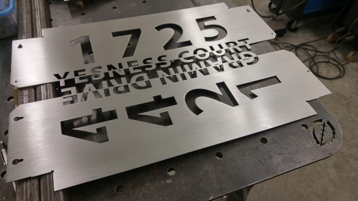

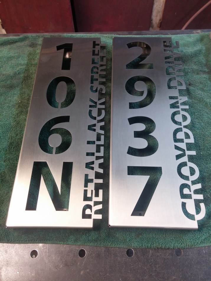

    You need a "rough" surface to allow a greater surface area for the powder to adhere to. Blasting is the fastest mechanical method to get this surface, however brushing can be done if the finish is desired. I'd never brush a finish to prep for an opaque powder coat, way too much work. That's why blasting or acid etching is normally done.
    These are some parts I just brushed this morning, will be forming and powder coating them shortly!
    [​IMG]
    This is a pair I finished a while back. Clear powder coat applied.
    [​IMG]
    You can't get a brushed finish with mill scale on the surface. Start with cold rolled material or else remove the mill scale hydrochloric acid.

    I have tried many methods and have now settled on using an Ingersoll Rand inline sander. It's around 18" long and has a 2-1/2" or so width of sandpaper. I find to create a nice brushed finish on a flat surface you have to use a sander with a flat surface. Grit all depends on the base material to start with. Sometimes you can start at 100+, sometimes you have to go 40/60 and work your way up. I don't go much past 180 for a #4 architectural brushed finish.
    Smoothing things out and softening the brushed finish can be done by sandwiching a scotchbrite pad between some heavy grit (40/60) sandpaper and the part itself. It helps even out the finish when I am finishing up the brushing process.
    This was shot when I switched from an the belt sander...to the inline sander. I don't use the belt sander much anymore now that I use the inline sander. You can see where I use the scotchbrite sandwiched between the sandpaper and the part. Can't do that with a belt sander!
